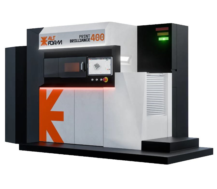

AltForm Print Brilliance 400
Four fully overlapping lasers across the largest build envelope in the range, with an XL configuration for parts up to 39 inches tall.
Build area: 16.54″ x 16.54″
Build height: 17.72″, XL 39.37″
Laser spot: 80 microns
  • Four ytterbium fiber lasers, single mode infrared, up to 1000 W each
  • 100% laser overlap, all four lasers reach the entire build area
  • Dynamic load balancing across all four lasers during the build
  • Rectangular build area, 16.54″ x 16.54″ x 17.72″ (420 x 420 x 450 mm)
  • Removable working chamber with automatic extraction
  • Gas-tight filtration with automatic backflushing and full passivation for 24/7 operation
  • Blockchain-based build certification for verified part history
  • Fleet management across every connected machine
  • Open Parameters architecture, with the option to lock a validated process for production
  • Materialise Magics
  • XL configuration, extending build height to 39.37″ (1,000 mm). Needs roughly 13 feet of vertical clearance and a site review before order.
  • Laser power configurations: 500 W, 700 W, or 1000 W per laser
Build Area 16.54" x 16.54" (420 x 420 mm)
Build Height, standard 17.72" (450 mm)
Build Height, XL 39.37" (1,000 mm)
Working Chamber Removable, automatic extraction
Laser Type 4 x ytterbium fiber, single mode infrared
Laser Power 500 W / 700 W / 1000 W per laser
Laser Overlap 100%, full build area
Build Rate Up to 4 x 100 cm³/h
Machine Dimensions, standard 153.54" x 82.68" x 98.43" (3,900 x 2,100 x 2,500 mm)
Machine Dimensions, XL 153.54" x 82.68" x 153.54" (3,900 x 2,100 x 3,900 mm)
Machine Weight, standard 6.000 kg (13.228 lbs)
Machine Weight, XL 8.000 kg (17.637 libras)
Your largest parts at your highest volume
This is the one machine in the range that pairs the full 16.54 inch envelope with four lasers. Build your largest components at up to 400 cubic centimeters an hour, on a plate that goes to 39.37 inches tall with the XL configuration.
