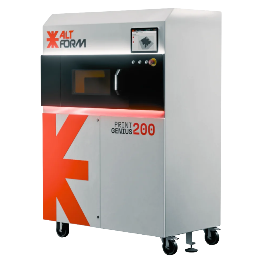

Dual-laser powder bed fusion with full-field overlap, built for small-batch production at higher throughput.
Build area: Ø7.87″
Build height: 7.87″
Laser spot: 60 microns
  • Two ytterbium fiber lasers, single mode infrared
  • 100% laser overlap, both lasers reach the entire build area
  • Dynamic load balancing across both lasers during the build
  • 60 micron laser spot diameter on focus
  • Layer thickness from 20 to 80 microns
  • Cylindrical build area, Ø7.87″ x 7.87″ (Ø200 x 200 mm)
  • Bidirectional recoater that spreads layers in both directions to speed up each pass
  • Open Parameters architecture with full control of laser power, scan strategy, and layer thickness
  • Single-phase 220 V power supply
  • Materialise Magics CAM software
  • Laser power configurations: 200 W, 300 W, or 500 W
Build Area Ø7.87" (Ø200 mm)
Build Height 7.87" (200 mm)
Laser Type 2 x ytterbium fiber, single mode infrared
Laser Power 200 W / 300 W / 500 W
Laser Spot Diameter 60 microns (on focus)
Layer Thickness 20 to 80 microns
Build Rate Up to 50 cm³/h
Power Supply 220 V / 32 A / 50 Hz
