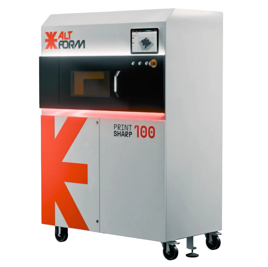

Print 100 Series
AltForm Print Sharp 100
Compact single-laser powder bed fusion for research, dental, and prototyping.
Build area: Ø5.12″
Build height: 5.12″
Laser spot: 60 microns
  • Single ytterbium fiber laser, single mode infrared
  • 60 micron laser spot diameter on focus
  • Layer thickness from 20 to 80 microns
  • Cylindrical build area, Ø5.12″ x 5.12″ (Ø130 x 130 mm)
  • Bidirectional recoater for reduced recoating time
  • Open Parameters architecture with full control of laser power, scan strategy, and layer thickness
  • AI-powered Human-Machine Interface with real-time process optimization
  • Single-phase 220 V power supply
  • Materialise Magics CAM software
  • Laser power configurations: 200 W, 300 W, or 500 W
Build Area Ø5.12" (Ø130 mm)
Build Height 5.12" (130 mm)
Laser Type Ytterbium fiber, single mode infrared
Laser Power 200 W / 300 W / 500 W
Laser Spot Diameter 60 microns (on focus)
Layer Thickness 20 to 80 microns
Build Rate Up to 50 cm³/h
Power Supply 220 V / 32 A / 50 Hz
Dimensiones de la máquina 43.31" x 23.62" x 70.87" (1,100 x 600 x 1,800 mm)
Peso de la máquina 1.000 kg (2.205 lbs)
Fine detail on small, high-value parts
A 60 micron laser spot and layers as thin as 20 microns to create intricate geometries on small parts. Built for dental frameworks, orthodontic components, and precision parts.
Qualify your own materials easily
Open Parameters gives your engineers direct control of laser power, scan strategy, and layer thickness. Develop a process for a new alloy, tune a proprietary powder blend, and keep the resulting parameter set as your own intellectual property.
Production capability in a lab-sized footprint
At 43 inches wide and running on a standard 220 V single-phase supply, the Print Sharp 100 installs in a university lab, a dental practice, an R&D bench, or a corner of an existing shop floor.
