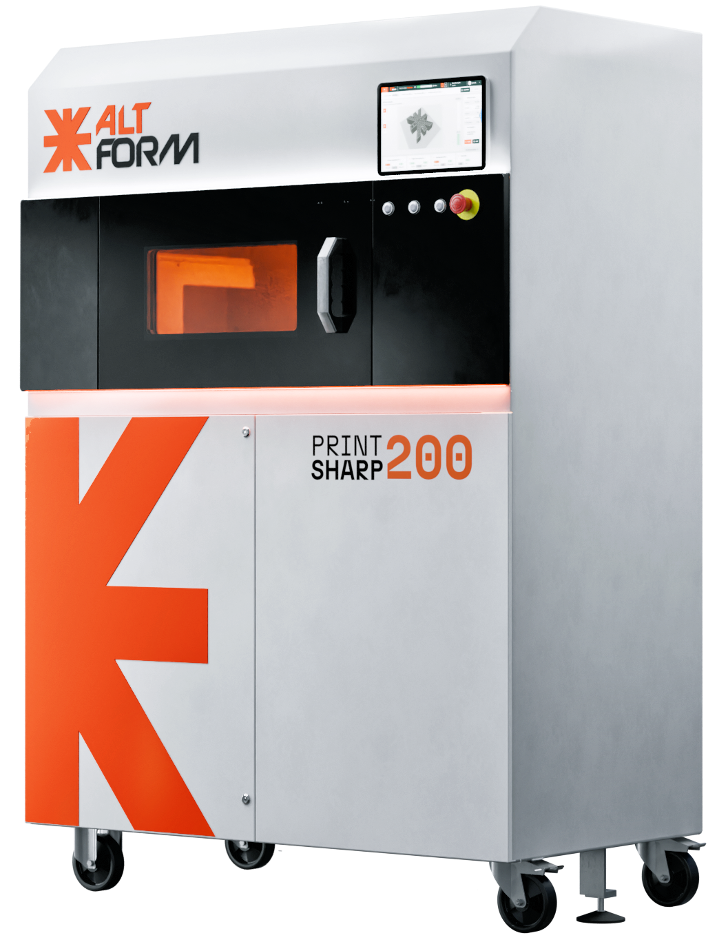

Print 200 Series
AltForm Print Sharp 200
Single-laser powder bed fusion for material qualification, small-batch production, and advanced prototyping.
Build area: Ø7.87″
Build height: 7.87″
Laser spot: 60 microns
  • Single ytterbium fiber laser, single mode infrared
  • 60 micron laser spot diameter on focus
  • Layer thickness from 20 to 80 microns
  • Cylindrical build area, Ø7.87″ x 7.87″ (Ø200 x 200 mm)
  • Bidirectional recoater that spreads layers in both directions to speed up each pass
  • Open Parameters architecture with full control of laser power, scan strategy, and layer thickness
  • Single-phase 220 V power supply
  • Materialise Magics CAM software
  • Laser power configurations: 200 W, 300 W, or 500 W
Build Area Ø7.87" (Ø200 mm)
Build Height 7.87" (200 mm)
Laser Type Ytterbium fiber, single mode infrared
Laser Power 200 W / 300 W / 500 W
Laser Spot Diameter 60 microns (on focus)
Layer Thickness 20 to 80 microns
Build Rate Up to 50 cm³/h
Power Supply 220 V / 32 A / 50 Hz
Dimensiones de la máquina 43.31" x 23.62" x 70.87" (1,100 x 600 x 1,800 mm)
Peso de la máquina 1.500 kg (3.307 lbs)
Take a qualified material into production
The Sharp 200 runs the same 60 micron laser spot and 20 to 80 micron layer range as the Sharp 100, in a build area more than three times the working volume.
Your process, your intellectual property
Open Parameters puts laser power, scan strategy, and layer thickness in your engineers’ hands. Qualify an alloy nobody has published parameters for, tune a proprietary powder blend, and own the recipe that comes out of it.
