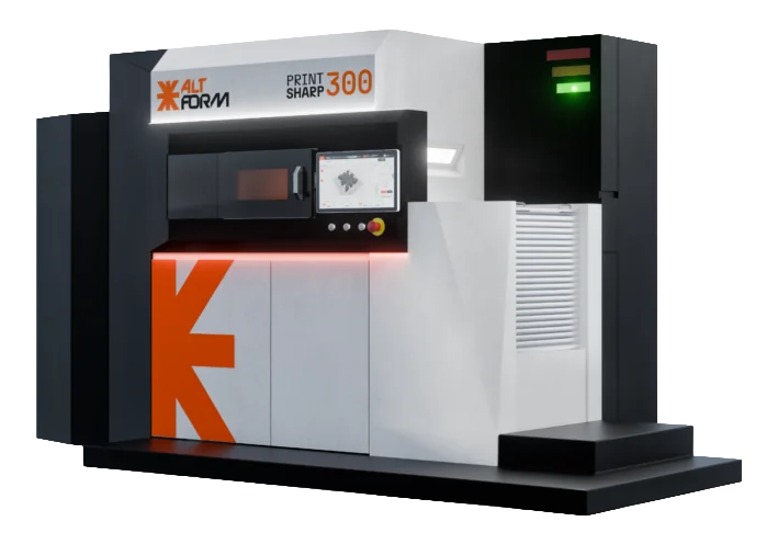

Single-laser powder bed fusion built for continuous full-scale production.
Build area: 12.99″ x 12.99″
Build height: 17.72″
Laser spot: 80 microns
  • Single ytterbium fiber laser, single mode infrared, up to 1000 W
  • Rectangular build area, 12.99″ x 12.99″ x 17.72″ (330 x 330 x 450 mm)
  • Removable working chamber for external depowdering
  • Automatic chamber extraction so the next build starts sooner
  • Gas-tight filtration with automatic backflushing and passivation for 24/7 operation
  • Open Parameters architecture with full control of laser power, scan strategy, and layer thickness
  • Blockchain-based build traceability
  • Materialise Magics
  • Laser power configurations: 500 W, 700 W, or 1000 W
Build Area 12.99" x 12.99" (330 x 330 mm)
Build Height 17.72" (450 mm)
Working Chamber Removable
Laser Type Ytterbium fiber, single mode infrared
Laser Power 500 W / 700 W / 1000 W
Build Rate Up to 100 cm³/h
Dimensiones de la máquina 153.54" x 82.68" x 98.43" (3,900 x 2,100 x 2,500 mm)
Peso de la máquina 5.000 kg (11.023 lbs)
Safer powder handling and faster changeovers
The working chamber extracts automatically, so depowdering, part removal, and cleaning happen at a separate station. Your operators spend less time around loose powder, and the machine is ready for its next job while the last build is still being processed.
Room for parts that stand tall
The working area allows for parts up to 17.72″ and allows for square and prismatic geometry across its full area. Up to
1000 W of laser power and layers to 120 microns move material fast enough to fill that envelope in a reasonable build time.
Built to run through the night
Gas-tight filtration with automatic backflushing and passivation keeps the machine going without an operator stopping to service the filter.
Start where you are, scale when you need to
Powder handling configures from manual loading up to a fully automated closed loop, and the Print Sharp 300 integrates with robotic part handling and production line automation. Buy the configuration that matches your volume today and add automation around the machine as that volume grows.
