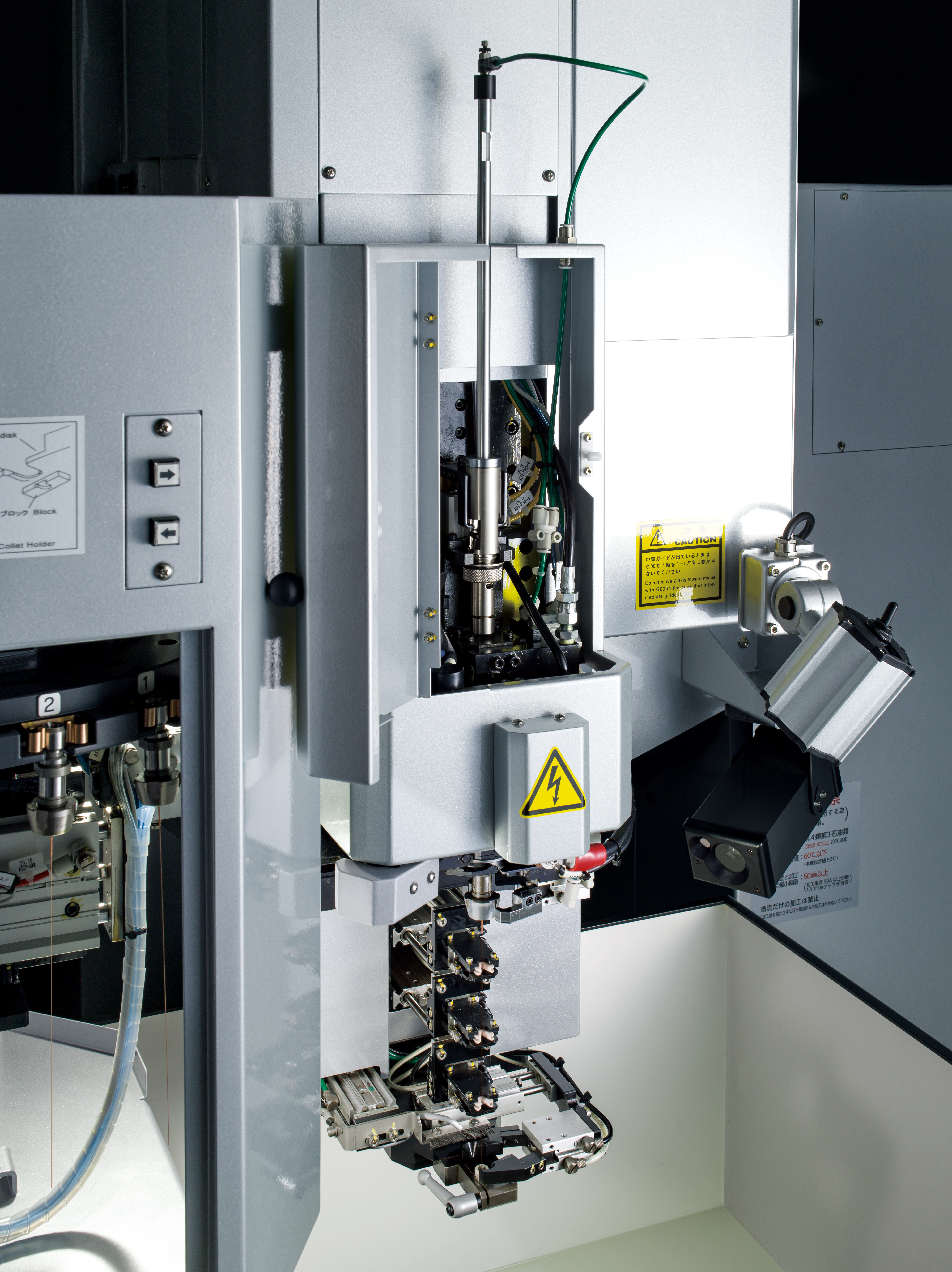

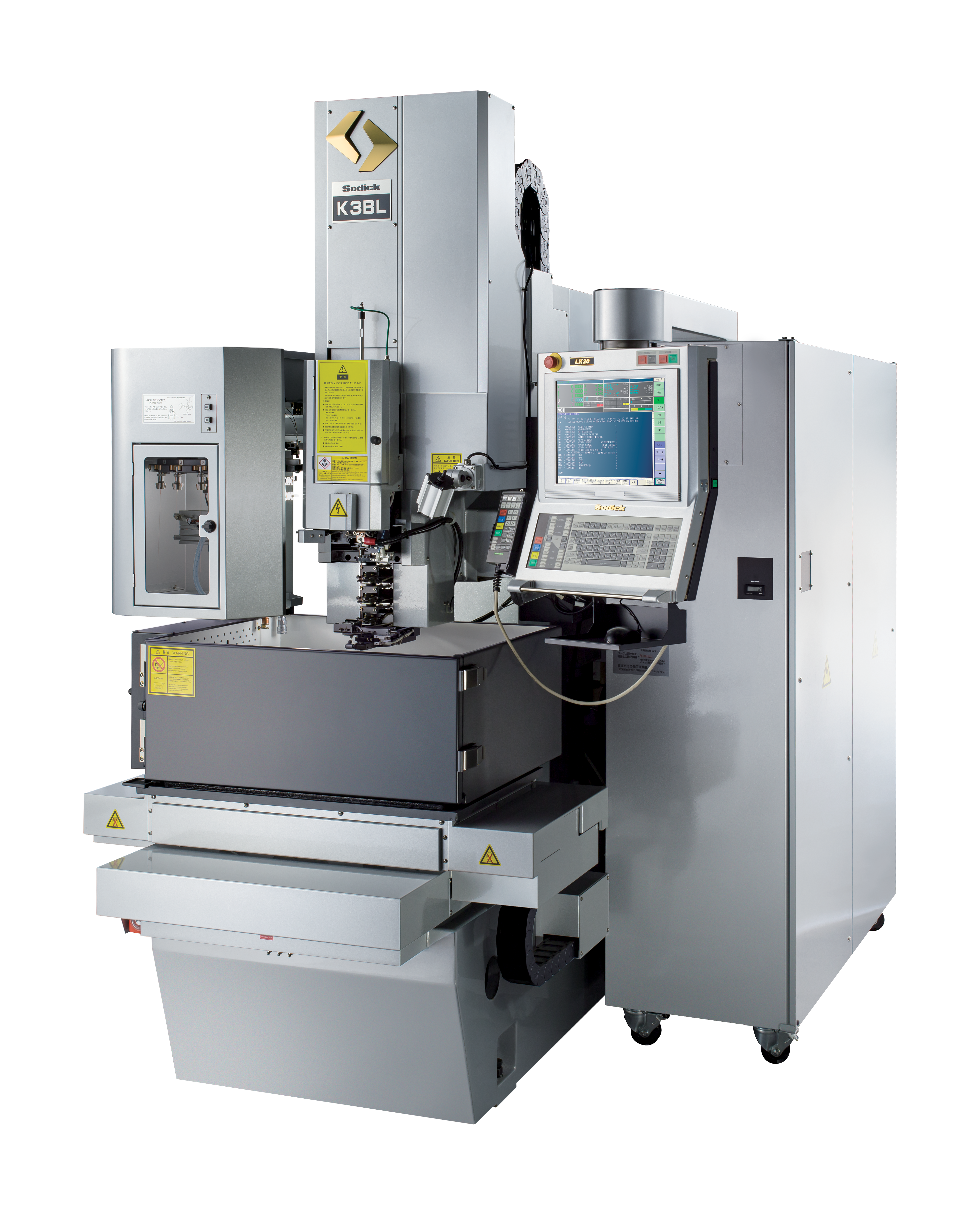

The K3BL is Sodick’s most versatile small hole EDM. It handles the widest electrode range of any machine in the K Series, from ultra-fine micro holes up to larger diameter drilling, so shops can take on more applications without additional equipment. Powered by Sodick’s rigid linear motor and the LN Assist control system, it delivers consistent precision across long production runs with automation options that keep the machine running with minimal operator involvement.
- Linear Motor Drive (Z-Axis Standard)
- LN Assist Automated Programming System (Standard)
- Ceramic Work Table

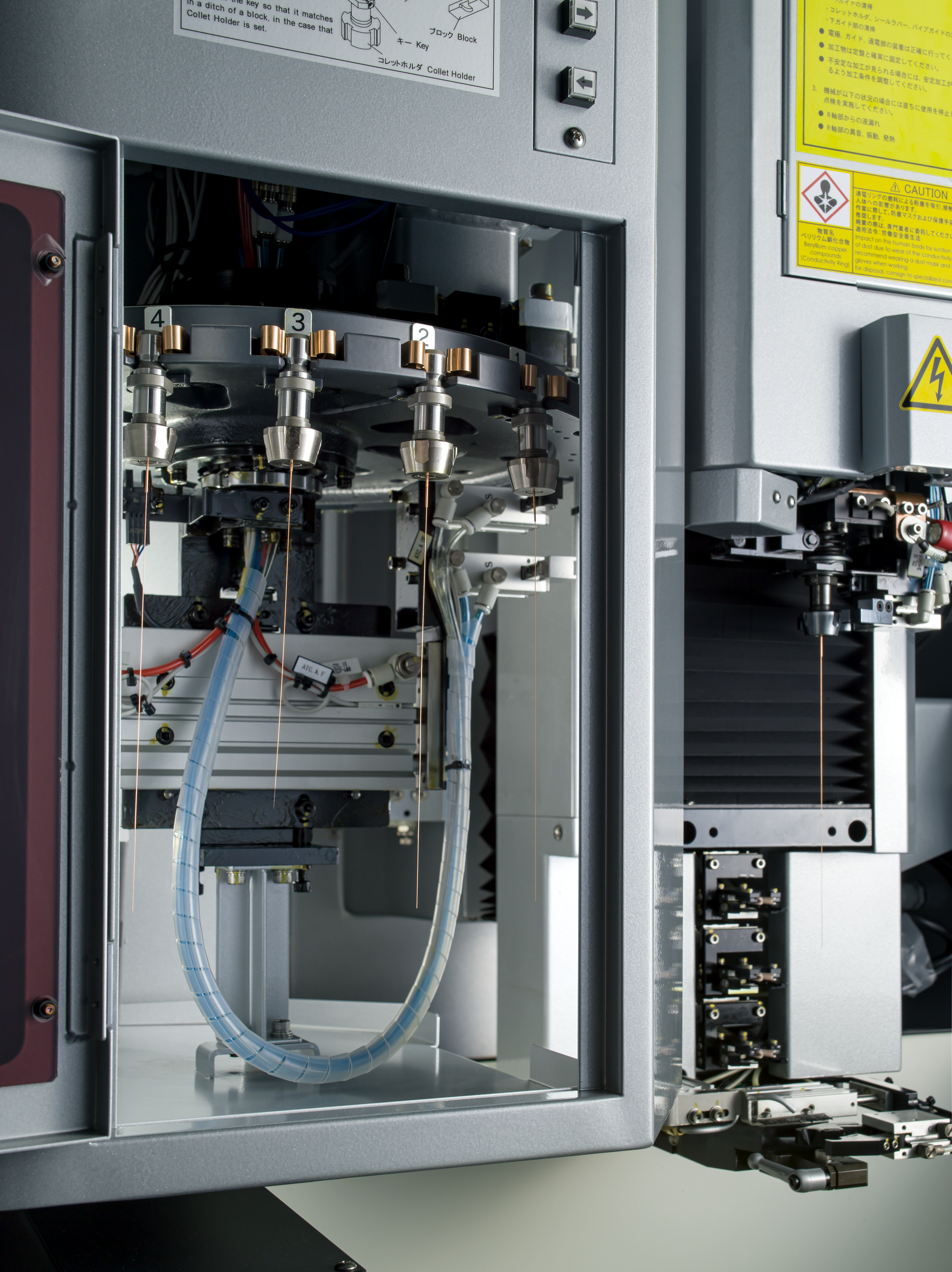

- 18 Automatic Tool Changer (ATC)
- 15 ATC + Automatic Electrode Feeder (AEF)
- Rotary Table
- Signal Tower Type 3
- UPS (Uninterruptible Power Supply)
| X-Axis Travel | 11.81" |
| Y-Axis Travel | 7.87" |
| Z-Axis Travel | 11.81" |
| W-Axis Travel | 9.84″ |
| Diámetro del electrodo | ø.003″ ~ .118″ |
| Tamaño de la mesa de trabajo | 23.62″ × 11.81″ |
| Distance from Guide to Table | 2.36″ ~ 12.20″ |
| Dimensiones de la máquina | 44.49″ × 64.76″ × 94.69″ |
| Maximum Workpiece Weight | 661.4 lbs |
| Peso de la máquina | 3,306.9 lbs |
| Presión atmosférica | 0.5 ~ 0.6 MPa |
| Total power input | 3 phase 200/220V, 0.75 kW |
| Dielectric Fluid | VITOL-V2 (oil-based) |
| Dielectric Tank Capacity | 64.72 gallon |
| Motor lineal | Standard on Z Axis |
| Automatización | ATC 18 / AEF + ATC 15 |
| Asistencia LN | Standard Feature |
| Rotary Table | Available as an Option |

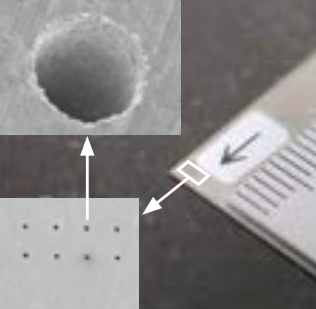

Muestras
Micro-Hole, 200 Holes ø.00217″
| Workpiece Material | WC/G5 |
| Workpiece Thickness | .0197″ |
| Electrode Material | Tungsten Rod ø.00118″ |
| Dielectric | Oil |
| Hole Diameter | In .00217″–.00244″ , Out .00228″–.00256″ |
| Cutting Time | 2–5 min/hole |
| Machine Tool | K3BL |

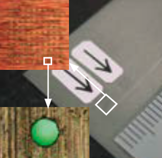

Micro-Hole, 10 Holes ø.00146″ (ø.037 mm)
| Workpiece Thickness | .0118″ |
| Electrode Material | Tungsten Rod ø.00079″ |
| Dielectric | Oil |
| Hole Diameter | In .00146″–.00150″, Out .00150″–.00157″ |
| Cutting Time | 6–8 min/hole |
