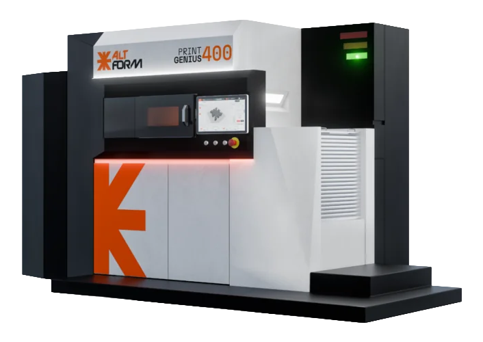

Print 400 Series
AltForm Print Genius 400
Dual-laser powder bed fusion for large components, with an XL configuration that builds parts up to 39 inches tall.
Build area: 16.54″ x 16.54″
Build height: 17.72″, XL 39.37″
Laser spot: 80 microns
  • Two ytterbium fiber lasers, single mode infrared, up to 1000 W each
  • 100% laser overlap, both lasers reach the entire build area
  • Dynamic load balancing across both lasers during the build
  • Rectangular build area, 16.54″ x 16.54″ x 17.72″ (420 x 420 x 450 mm)
  • Removable working chamber with automatic extraction
  • Gas-tight filtration with automatic backflushing and full passivation for 24/7 operation
  • Blockchain-based build certification for verified part history
  • Fleet management across every connected machine
  • Open Parameters architecture, with the option to lock a validated process for production
  • Materialise Magics
  • XL configuration, extending build height to 39.37″ (1,000 mm)
  • Laser power configurations: 500 W, 700 W, or 1000 W per laser
Build Area 16.54" x 16.54" (420 x 420 mm)
Build Height, standard 17.72" (450 mm)
Build Height, XL 39.37" (1,000 mm)
Working Chamber Removable, automatic extraction
Laser Type 2 x ytterbium fiber, single mode infrared
Laser Power 500 W / 700 W / 1000 W per laser
Laser Overlap 100%, full build area
Build Rate Up to 2 x 100 cm³/h
Machine Dimensions, standard 153.54" x 82.68" x 98.43" (3,900 x 2,100 x 2,500 mm)
Machine Dimensions, XL 153.54" x 82.68" x 153.54" (3,900 x 2,100 x 3,900 mm)
Machine Weight, standard 6.000 kg (13.228 lbs)
Machine Weight, XL 8.000 kg (17.637 libras)
Build tall parts in a single piece
The XL configuration takes build height to 39.37 inches. Components that would otherwise be produced in sections and joined in a separate process now come off the plate as one continuous piece with no weld line.
A verified build record for every part
Each build writes its own history of parameters and process data, sealed with blockchain certification so it can be checked later. When a customer, an auditor, or your own quality team asks how a specific part was made, the answer is on record.
Print the alloys your specs call for
Titanium, aluminum, nickel alloys, cobalt-chrome, and steels all run on this machine. Oxygen stays monitored below 100 ppm for the full build and argon shielding is available for the reactive alloys, such as titanium and aluminum.
