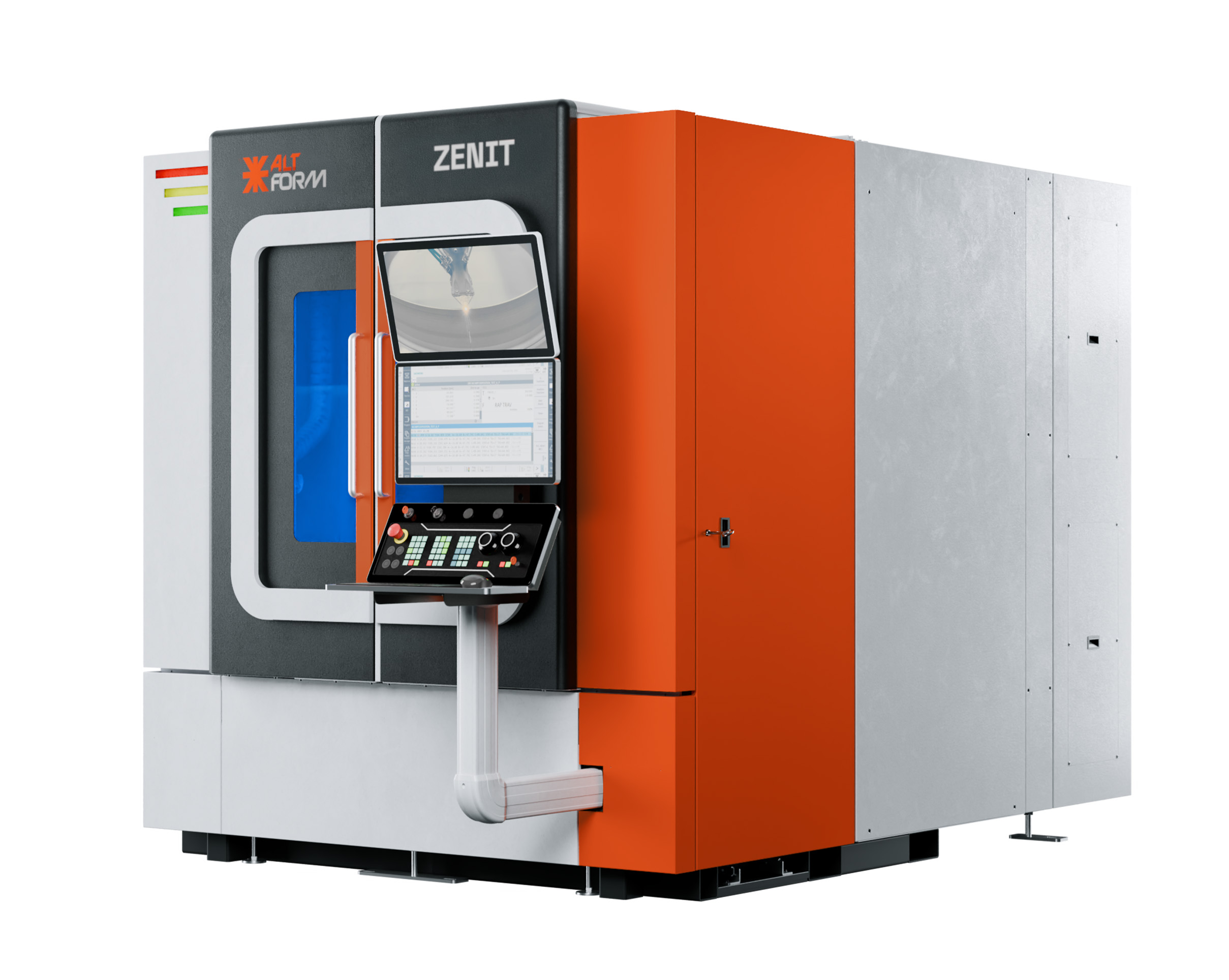

Direct energy deposition in a robotic cell, for building, repairing, and coating large parts.
Work envelope: 62.99″ x 47.24″ x 27.56″
Laser: 2kW and above
Feedstock: Wire or powder
  • Modular robotic cell built for direct energy deposition and advanced laser processes
  • Work envelope of 62.99″ x 47.24″ x 27.56″ (1,600 x 1,200 x 700 mm)
  • Laser source from 2 kW
  • Powder or wire feedstock
  • Laser or electric arc energy source, including wire arc additive manufacturing
  • Up to two deposition heads
  • Siemens CNC control, with machine and robot programmed from one interface in standard G-code
  • Metallurgical bond between deposited material and substrate
  • Suited to building, repairing, cladding, and surface functionalization

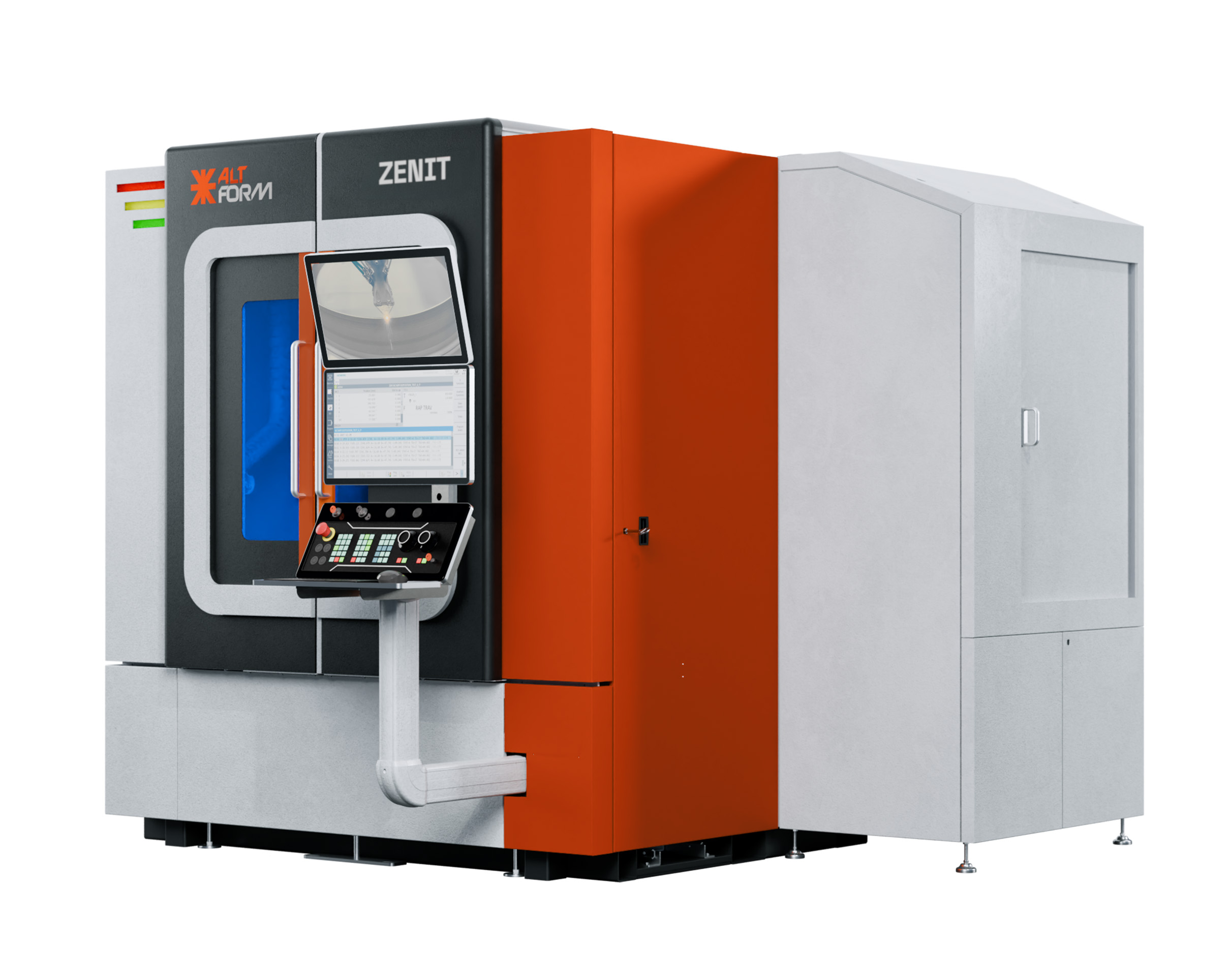

  • Single process: One deposition process, full 62.99″ x 47.24″ x 27.56″ envelope.
  • Multi process: Powder DED, wire DED, and wire arc additive manufacturing in one cell, full envelope.

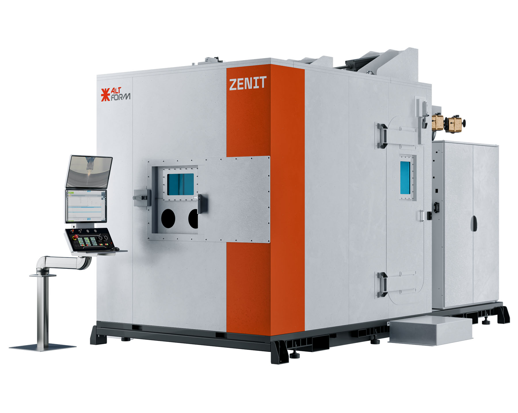

  • Inert gas chamber: Sealed argon atmosphere for reactive alloys, using AltForm’s patented rapid inerting. Envelope of 31.50″ x 31.50″ x 23.62″ (800 x 800 x 600 mm), customizable.

One cell for building, repairing, and coating
Wire deposition lays material down fast for large structural builds. Powder deposition gives finer control where dimensional accuracy and surface definition matter. Cladding applies a wear or corrosion layer that bonds metallurgically to the part underneath. A multi-process cell does all three, and two heads can run at once.
User friendly for CNC programmers
The cell runs on Siemens control, and the machine and the robot are programmed from one interface in standard G-code. The people who already program your machine tools can program this, using a language and a control system they know.

  • Sealed argon atmosphere for reactive alloys, using AltForm’s patented rapid inerting
  • Envelope of 31.50″ x 31.50″ x 23.62″ (800 x 800 x 600 mm), customizable
