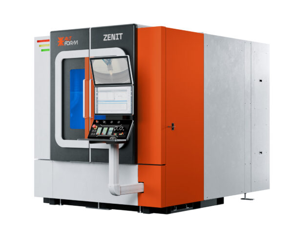

Direct energy deposition in a robotic cell, for building, repairing, and coating large parts.
Work envelope: 62.99″ x 47.24″ x 27.56″
Laser: 2kW and above
Feedstock: Wire or powder
  • Modular robotic cell built for direct energy deposition and advanced laser processes
  • Work envelope of 62.99″ x 47.24″ x 27.56″ (1,600 x 1,200 x 700 mm)
  • Laser source from 2 kW
  • Powder or wire feedstock
  • Laser or electric arc energy source, including wire arc additive manufacturing
  • Up to two deposition heads
  • Siemens CNC control, with machine and robot programmed from one interface in standard G-code
  • Metallurgical bond between deposited material and substrate
  • Suited to building, repairing, cladding, and surface functionalization

Rebuild tooling instead of replacing it
A production mold represents six figures of tooling and months of lead time. The
ZENIT Cell allows you to repair instead of replace. The process deposits new material into the worn area so the tool can be ground and polished back to spec.
One cell for building, repairing, and coating
Wire deposition lays material down fast for large structural builds. Powder deposition gives finer control where dimensional accuracy and surface definition matter. Cladding applies a wear or corrosion layer that bonds metallurgically to the part underneath. A multi-process cell does all three, and two heads can run at once.
User friendly for CNC programmers
The cell runs on Siemens control, and the machine and the robot are programmed from one interface in standard G-code. The people who already program your machine tools can program this, using a language and a control system they know.
