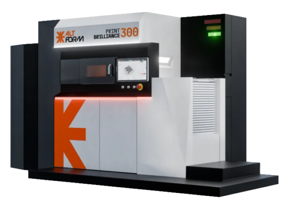

AltForm Print Brilliance 300
Four fully overlapping lasers in a single cabinet, built for the highest output per square foot of floor space.
Build area: 12.99″ x 12.99″
Build height: 17.72″
Laser spot: 80 microns
  • Four ytterbium fiber lasers, single mode infrared, up to 1000 W each
  • 100% laser overlap, all four lasers reach the entire build area
  • Dynamic load balancing across all four lasers during the build
  • Rectangular build area, 12.99″ x 12.99″ x 17.72″ (330 x 330 x 450 mm)
  • Removable working chamber with automatic extraction
  • Gas-tight filtration with automatic backflushing and passivation for 24/7 operation
  • Blockchain-based build certification for verified part history
  • Fleet management across every connected machine
  • Open Parameters architecture, with the option to lock a validated process for production
  • Materialise Magics
  • Laser power configurations: 500 W, 700 W, or 1000 W per laser
Build Area 12.99" x 12.99" (330 x 330 mm)
Build Height 17.72" (450 mm)
Working Chamber Removable, automatic extraction
Laser Type 4 x ytterbium fiber, single mode infrared
Laser Power 500 W / 700 W / 1000 W per laser
Laser Overlap 100%, full build area
Build Rate Up to 4 x 100 cm³/h
Machine Dimensions 153.54" x 82.68" x 98.43" (3,900 x 2,100 x 2,500 mm)
Machine Weight 11,023 lbs (5,000 kg)
Four times the output
Four lasers work inside the same work area to achieve highly intricate geometries in a fraction of the time.
A verified build record for every part
Each build writes its own history of parameters and process data, sealed with blockchain certification so it can be checked later. When a customer, an auditor, or your own quality team asks how a specific part was made, the answer is a record.
Oversee production from your phone
Fleet management brings every connected machine into a single view, with build status, process data, and performance across the group. Check a running job from your phone, see which machine is free, and catch a problem from the next building over.
