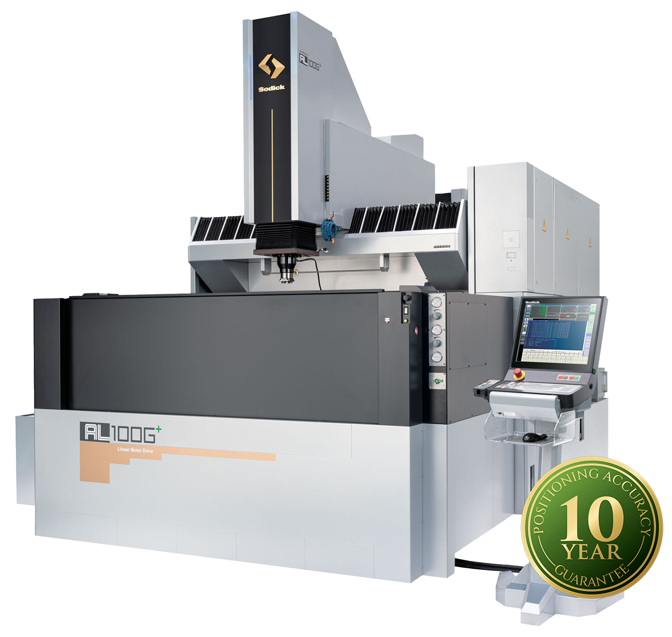

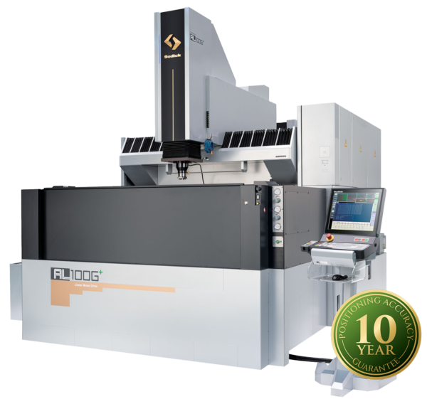

AL100G+
Sodick presents the large ALG+ Sinker-EDM, the AL100G+. Needless to say, the model features all the in-house made technologies of Sodick.
X-Travel: 47.24″(1,200 mm)
Y-Travel: 25.60″ (650 mm)
Z-Travel: 19.69″ (500 mm)
