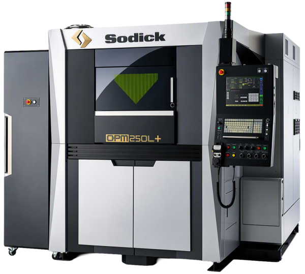

OPM250L+
The OPM250L vastly outperforms laser-only printers in the production of complex parts, slashing manned post-process operations, replacing them with a seamless unmanned process.

The OPM250+ is a single process machine which combines laser metal sintering and high speed milling within the same workspace, allowing users to create finished 3D printed molds within a single machine. This additive technology allows not only for improved mold cooling channels and cycle times, but also streamlines mold design, significantly reducing the number of components necessary to create a complete mold.
  • Yb Fiber Laser Sintering
  • Fully Integrated High Speed Milling
  • Dedicated Laser Sintering/Machining CAM System
  • Rigid Linear Motor Drives
  • Absolute Glass Scale Feedback
  • Sodick Motion Controller
  • 16-Position Automatic Tool Changer
  • Automatic Material Recovery System (MRS Unit)
  • Materialise Magics for Metal Software Package
Max workpiece size 9.84" x 9.84" x 9.84" (250 x 250 x 250 mm)
X-Axis Travel 10.24" (260 mm)
Y-Axis Travel 10.24" (260 mm)
Z-Axis Travel 10.24" (260 mm)
Spindle z axis stroke 3.94" (100 mm)
Molding tank inner dimension 11.42" (290 x 290 mm)
Max Laser Output 500 W
Max powder feed amount 198.42 lbs. (90 kg) (Maraging Steel)
Nitrogen supply capacity 32NL/min
Max spindle rpm 45,000
Tool holder type HSK-E25
Machine Tool Dimensions 73.62" x 87.80" x 80.91" (1,870 x 2,230 x 2,055 mm)
Machine Tool Weight 9,920 lbs. (4,500 kg)
Sodick’s OPM250L+ combines metal 3D printing and precision machining in a single workspace, alternating both processes throughout production. This integrated approach delivers superior accuracy, surface finish, and dimensional control compared to conventional systems that machine only after printing. By machining features as they are built, the OPM250L+ produces complex geometries that are difficult or impossible with traditional manufacturing. The result is greater design freedom, often consolidating more than 20 mold components into a single high-performance mold that reduces assembly, improves reliability, and boosts productivity.
Among the key advantages of metal additive manufacturing is the ability to create conformal cooling channels that closely follow the contours of a mold. By positioning cooling channels nearer to the mold surface, conformal cooling delivers more uniform temperature control, reduces part deformation, and shortens cycle times. Using this technology, Sodick has achieved cooling time reductions of up to 50% and overall cycle time improvements of up to 21%, helping manufacturers increase productivity while maintaining consistent part quality.
Sodick’s dedicated OPM CAM software, OS-FLASH, integrates model import, laser data generation, machining optimization, and simulation in a single platform. Compatible with IGES, STEP, STL, and Parasolid files, OS-FLASH uses proprietary algorithms to rapidly generate laser and machining data. STL support enables mold production directly from scanned data, while automatic high-load detection optimizes feed rates in grooves, corners, and other critical areas. Built-in simulation verifies machining results, identifies overcut or unmachined sections, and accurately calculates machining time.
After machining is complete, the OPM250L+ automatically recovers unused metal powder from the build area and recycles it back into the material supply system. This efficient powder management process reduces material waste, lowers operating costs, and maximizes material utilization for more cost-effective metal additive manufacturing.
Sodick’s OPM250L+ features the same flat rigid linear motor technology that has helped make our EDM machines an industry benchmark for accuracy and reliability. Delivering 1G axis acceleration with no friction, wear, or backlash, these advanced drives provide smooth, stable motion and precise positioning. Directly integrated into the machine castings, the flat rigid linear motors enhance rigidity and digital motion control, helping the OPM250L+ achieve exceptional accuracy in metal additive manufacturing.
The Sodick Motion Controller precisely coordinates the high-speed, rigid linear motor drives through advanced NC control, delivering exceptional accuracy, rapid acceleration, and precise positioning. Developed through extensive research and innovation in Silicon Valley, the Sodick Motion Controller is a core technology that enhances machining performance, accuracy, and productivity across Sodick machine tools.
